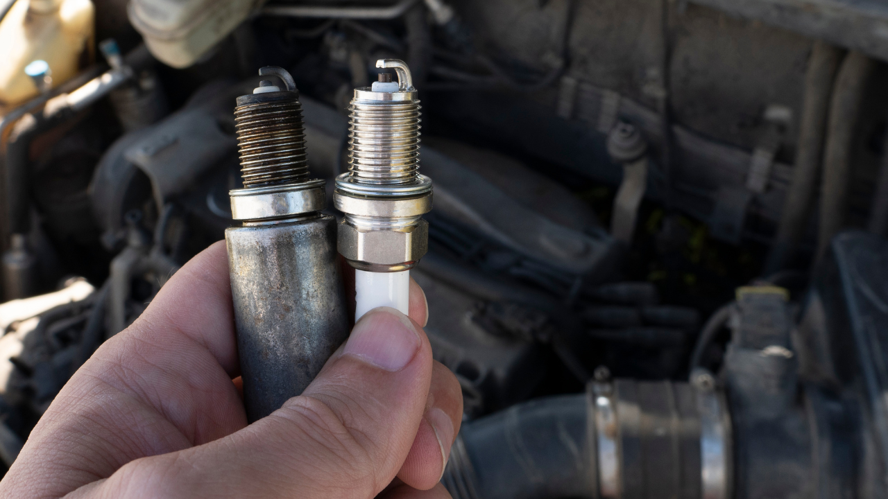

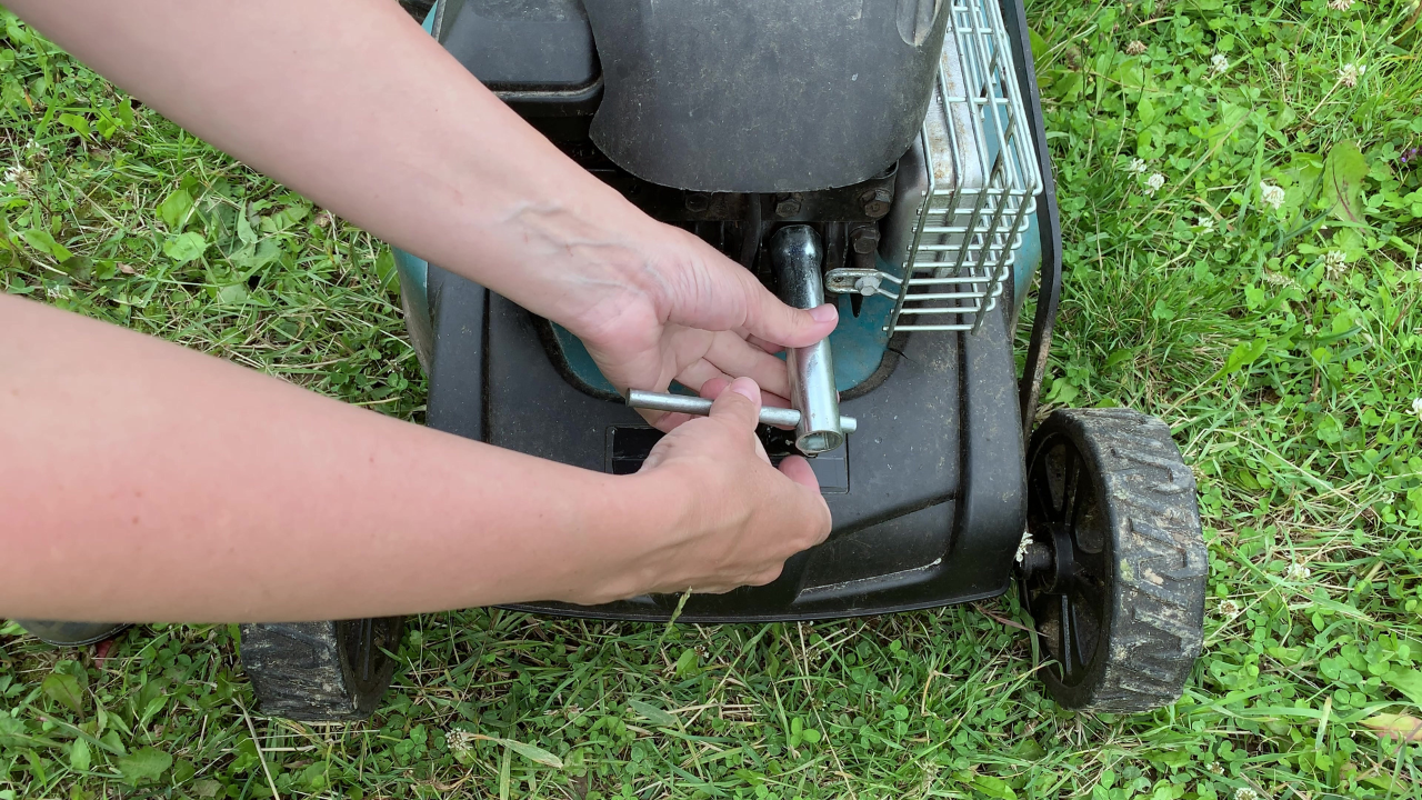

Next, use a spark plug wrench or a ratchet with the correct socket size (usually 5/8-inch or 13/16-inch, depending on your mower model). Turn the plug counterclockwise until it loosens and comes free. Once removed, examine the plug carefully:
  • If it’s coated with black carbon deposits, your engine may be running too rich.
  • If it’s oily, there could be an issue with oil leaking into the combustion chamber.
  • If the electrode is burned or worn, it’s a clear sign it’s overdue for replacement.
Keeping the old plug handy can also help you confirm that the new one matches in length, thread size, and shape.

Now it’s time to install the replacement. Start by hand-threading the plug into the cylinder head to avoid cross-threading—a common mistake that can damage the engine. Once you feel it’s snug, use your wrench to give it a final turn.
The rule of thumb is about a quarter-turn past hand-tight for a new plug. If you’re using a torque wrench, check your mower’s manual for the recommended torque (usually around 15–20 ft-lbs). Avoid overtightening, as this can strip the threads or crack the ceramic insulator, leading to expensive repairs.
