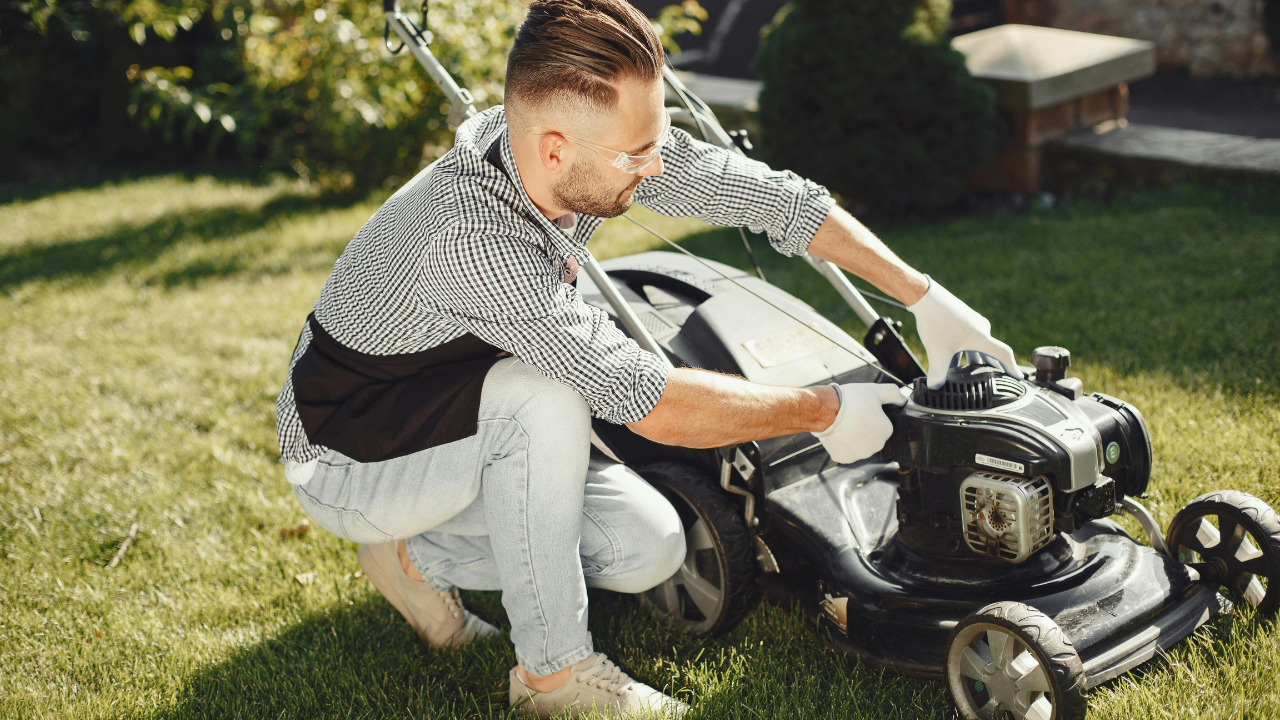

Lawn mower fuel check
Preventing Clogs and Fuel Contamination
  • Replace fuel filters every 1–2 seasons.
  • Inspect fuel lines annually for cracks or leaks.
  • Clean or rebuild carburetors if starting issues persist.
