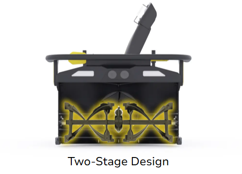

Yarbo’s Snowblower Auger: Design, Pain Points, Fixes
Yarbo’s autonomous snowblower module aims to automate snow clearing—but even high-tech machines experience auger issues.

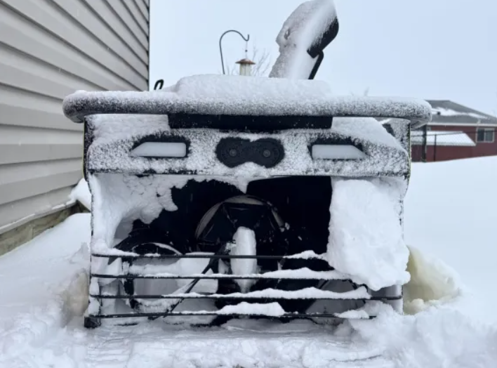

  1. Community Reports on Shear Pins
  • Yarbo forum users report frequent shear-pin “eating” in wet conditions
  • Wet snow can break 6–8 shear pins per session, with a user lamenting:
“Wet snow… destroyed my Yarbo. I’ve now gone through 6–8 shear pins … $40 for a handful? These should be cheap.”
  1. Auger Clogs & Over‑Current Errors
  • Facebook group advice: "Auger overcurrent means the auger is blocked—clear with plastic rod then hit clear error"
  1. Design & Safety Features
Yarbo engineers embed multiple layers of safety and control:
  • Adjustable auger settings via mobile app
  • Triple-layer safety fence and required guards for each operation
  1. Wet‑Snow & Turbo Mode Tips
  • Turbo-mode auger speed combats heavy, wet snow
  • Removing protection fence and using ceramic-coated auger surfaces helps reduce build-up.
  1. Hardware Evolution
In recent updates, Yarbo has:
  • Reinforced metal gear reducers.
  • Improved torque in motors.
  • Made height‑adjustable auger mounting easier to reduce clogging.
