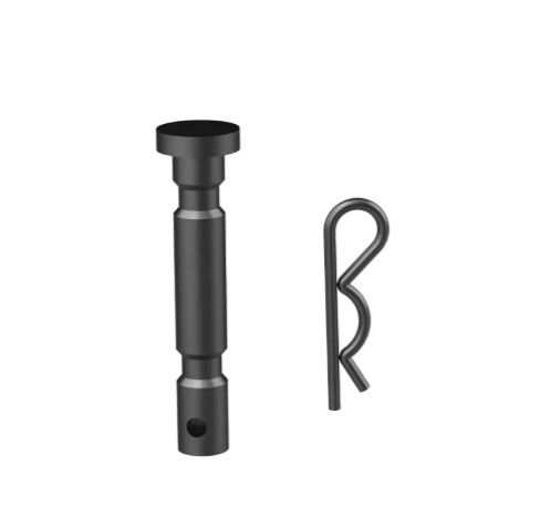

A shear pin as the name suggests is a small, purpose-designed metal pin that connects your snow blower's auger (the rotating blades that scoop up snow) to its drive shaft, allowing the auger to spin and clear snow effectively.
Its key function is to act as a mechanical safety device: it is engineered to break cleanly if the auger encounters a hard object (like ice, rocks, or thick debris).
This controlled breakage prevents the impact force from damaging more expensive and critical parts of your snow blower, such as the gearbox, auger shaft, or engine.

Types of Shear Pins for Snow Blowers
OEM vs Universal Shear Pins
OEM shear pins are designed for your specific model, while universal pins may fit multiple models but may not provide the exact strength required.
Material and Durability Factors
Most shear pins are made of soft metal alloys to break easily when required while maintaining sufficient strength during regular use.
